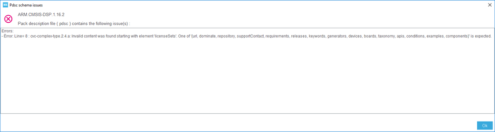

I also tried to install the ARM DSP pack (specifically ARM.CMSIS-DSP.1.16.2.pack) into STM32CubeIDE using the Embedded Software Packages Manager but it fails with an error:
