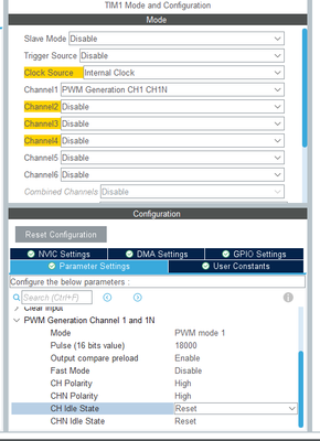

I am running TMR1 CH1 and CH1N in complementary mode (so they are the opposite of each other).
Using a HAL function, how do I change each (separately) from PWM to GPIO and back to PWM?
Just so to explain what I am trying to do... I am driving a H-bridge, I want to be able to:
- run the PWM in complementary mode (i.e. biphase/bipolar bridge)
- fix one half of the bridge to high or low while the other side still runs in PWM
- switch both to either high or low
- go back to full PWM complementary
Thank you

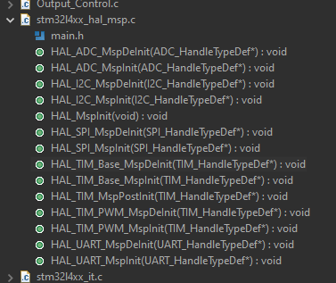

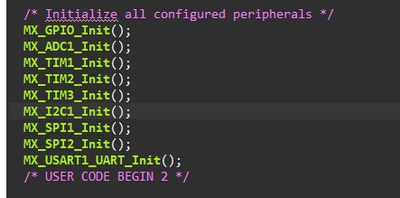

2024-08-04 6:55 PM
Thank you @TDK
I just tried implementing what you suggested i.e. calling HAL_TIM_MspInit() but there is no sign of it in the generated code anywhere in the project. There are other MspInit() functions as you can see from the screenshot here but not that one.
The only functions generated by CubeMX are these:
I am new to STM32 so I am wondering if it could be because I am using CH1 and CH1N with TMR1 configured like in the screenshot below? The generated complementary PWM outputs are correct on the oscilloscope but perhaps I configured it incorrectly or in a less than ideal manner (although )? Maybe using different settings would generate the HAL_TIM_MspInit() you are referring to? Or perhaps I need to #include some header?
Thank you again! :)
2024-08-04 7:14 PM - edited 2024-08-04 7:14 PM
HAL_TIM_PWM_MspInit probably. Or maybe HAL_TIM_Base_MspInit
Whatever function the pins are initialized in.
2024-08-04 8:08 PM - edited 2024-08-05 4:34 AM
Thank you
and really sorry about this but I have been looking at all those functions, but unless I am missing something, it does not appear the pins are initialised in any of them.
I am new to STM32, perhaps initialisation is there but in a form I don't recognise?
The PWM pin names are OUTPUT_PWM_2 and OUTPUT_PWM_1 on PA7 and PA8. But I don't see them addressed anywhere in any of the project files.
Thank you

2024-08-05 6:36 AM
Hmm, pins have to be initialized somewhere, if they're working.
I created a project to test this, it looks like they're being initialized in HAL_TIM_MspPostInit. Can you check for that?
void HAL_TIM_MspPostInit(TIM_HandleTypeDef* htim)
if(htim->Instance==TIM8)
/* USER CODE BEGIN TIM8_MspPostInit 0 */
/* USER CODE END TIM8_MspPostInit 0 */
__HAL_RCC_GPIOA_CLK_ENABLE();
__HAL_RCC_GPIOC_CLK_ENABLE();
/**TIM8 GPIO Configuration
PA7 ------> TIM8_CH1N
PC6 ------> TIM8_CH1
GPIO_InitStruct.Pin = GPIO_PIN_7;
GPIO_InitStruct.Alternate = GPIO_AF3_TIM8;
GPIO_InitStruct.Pin = GPIO_PIN_6;
HAL_GPIO_Init(GPIOC, &GPIO_InitStruct);
/* USER CODE BEGIN TIM8_MspPostInit 1 */
/* USER CODE END TIM8_MspPostInit 1 */
}If that doesn't work, please attach your IOC file and I will take a look..
2024-08-05 1:10 PM
Thank you @TDK
yes I found it and it works. :thumbs_up:
