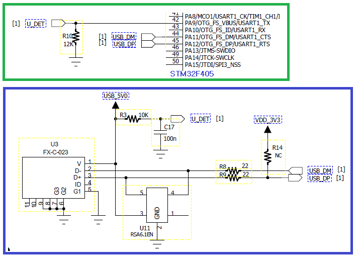

I'm using the STM32CubeMX 4.3.0 version.I created a project for CDC Virtual COM port for STM32F405RG micro. I need full duplex communication. Please find the attached CubeMX project .ioc file.
Following is the USB schematic of the board.static

I have changed a line in
CDC_Transmit_FS
function to use it from main.c file to write data to USB. How can I get data out ofUserRxBufferFS
buffer as there is no code insideCDC_Receive_FS
function ? In my application, I need full duplex USB communication. Please through some code samples for this project. I have seen CDC_Standalone example in STM32Cube_FW_F4_V1.3.0\Projects\STM324x9I_EVAL\Applications\USB_Device\CDC_Standalone But this is quite different from what I want to achieve ( this is USB to RS232 bridge sample) #virtual-com-port #cdc #stm32f4We’re moving the ST Community to a new platform to give you a better and more reliable community experience.
