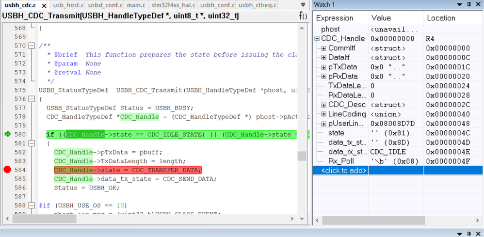

However when I send a USBH_CDC_Transmit API then that packet does not get send out. I did debug the code see below. I did find the point where the transmit fails to initiate the packet based on the CDC_Handle status (incorrect status code e.g. 0x81 instead of CDC_IDLE etc).

I followed Breakpoint to
usbh_cdc.c routine
* @brief This function prepares the state before issuing the class specific commands
* @param None
* @retval None
USBH_StatusTypeDef USBH_CDC_Transmit(USBH_HandleTypeDef *phost, uint8_t *pbuff, uint32_t length)
USBH_StatusTypeDef Status = USBH_BUSY;
CDC_HandleTypeDef *CDC_Handle = (CDC_HandleTypeDef *) phost->pActiveClass->pData;
if ((CDC_Handle->state == CDC_IDLE_STATE) || (CDC_Handle->state == CDC_TRANSFER_DATA))
// --->Here the if then statement breaks... CDC_Handle->state = 0x81 which is not a valid enum state at all e.g. CDC_IDLE_STATE etc.

Finally found the issue... too much time behind the PC.
The error is in the definition-->extern uint8_t USBH_CDC_Transmit(uint8_t* Buff, uint16_t Lenn);
USBH_CDC_Transmit takes three arguments instead of two (phost is missing).
