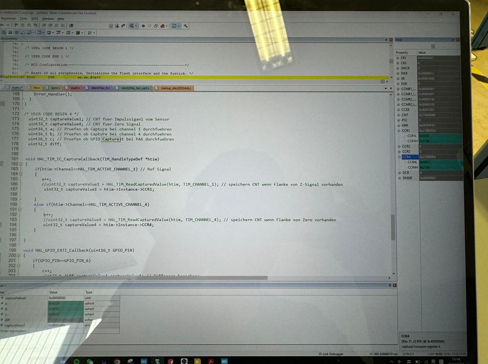

My code and debug screenshots are as follows.
  uint32_t captureValue1;
  uint32_t captureValue4;
  uint16_t a;
  uint16_t b;
  uint16_t c;
  uint32_t diff;
 void HAL_TIM_IC_CaptureCallback(TIM_HandleTypeDef *htim)
if(htim->Channel==HAL_TIM_ACTIVE_CHANNEL_1) // Ref Signal
a++;
//uint32_t captureValue1 = HAL_TIM_ReadCapturedValue(htim, TIM_CHANNEL_1);
uint32_t captureValue1 = htim->Instance->CCR1;
else if(htim->Channel==HAL_TIM_ACTIVE_CHANNEL_4)
b++;
//uint32_t captureValue4 = HAL_TIM_ReadCapturedValue(htim, TIM_CHANNEL_4);
uint32_t captureValue4 = htim->Instance->CCR4;
 void HAL_GPIO_EXTI_Callback(uint16_t GPIO_PIN)
if(GPIO_PIN==GPIO_PIN_6)
c++;
uint32_t diff=captureValue4-captureValue1;
char buffer[10];
int len= sprintf(buffer,"%u\r\n", diff);
  HAL_UART_Transmit(&huart2, (uint8_t*)buffer, len, HAL_MAX_DELAY);
This creates a new local variable called "captureValue1", which immediately goes out of scope. You probably want to modify the global variable, which is done like this:

Thank you TDK,
Just as you mentioned, I forgot to set my variable as a global variable. Thank you for your reply
