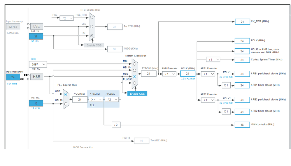

I created a blank CubeMx project for the stm32l151VETx and changed the following things:
System Core > RCC > HSE > Crystal / Ceramic Resonator
Connectivity > USB > Device(FS)
Middleware > Class For FS IP > Communication Device Class (Virtual Port Com)
Clock config to:
Then I generated the code and used STM Workbench to compile and upload the code. If I use the debugger I can also step through the code and it seems to run normally. But no usb devices shows up.

Check the CubeL1 repository for VCP Device examples
Check HSE_VALUE define, check clocks/plls as reported by RCC register decomposition.
