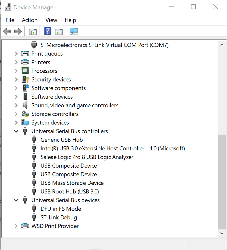

I believe I am in the ST bootloader because if I plug a USB cord into the computer on the bottom USB (not the top ST-Link USB), DFU FS Mode shows up in the device manager. I am performing a power cycle between each iteration of testing for trying to enter the SPI Bootloader mode to prevent testing SPI sequences and accidently entering the wrong mode.

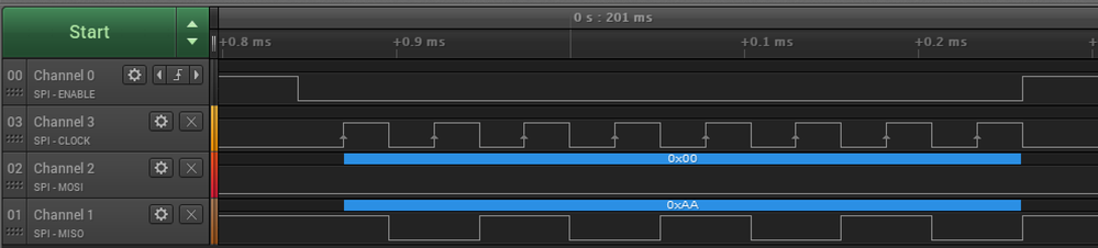

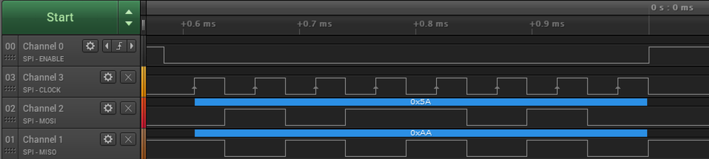

After power cycling and waiting more than 2-3 seconds (watching for the 1 second of yellow LED flashing I have added before the jump the bootloader) I start the following SPI communication:
MOSI MISO
0x5A 0xAA
200ms Delay
0x00 0xAA
200ms Delay
0x5A 0xAA
0xAA 0xAA
0x55 0xAA
0x00 0xAA

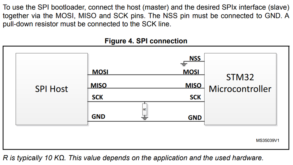

My physical connection for the SPI is the same as Figure 4 in AN2606 Rev 46:
I am using two 22kOhm resistors in parallel measured to be 10.8kOhm for the pull down resistor on the SCK line.

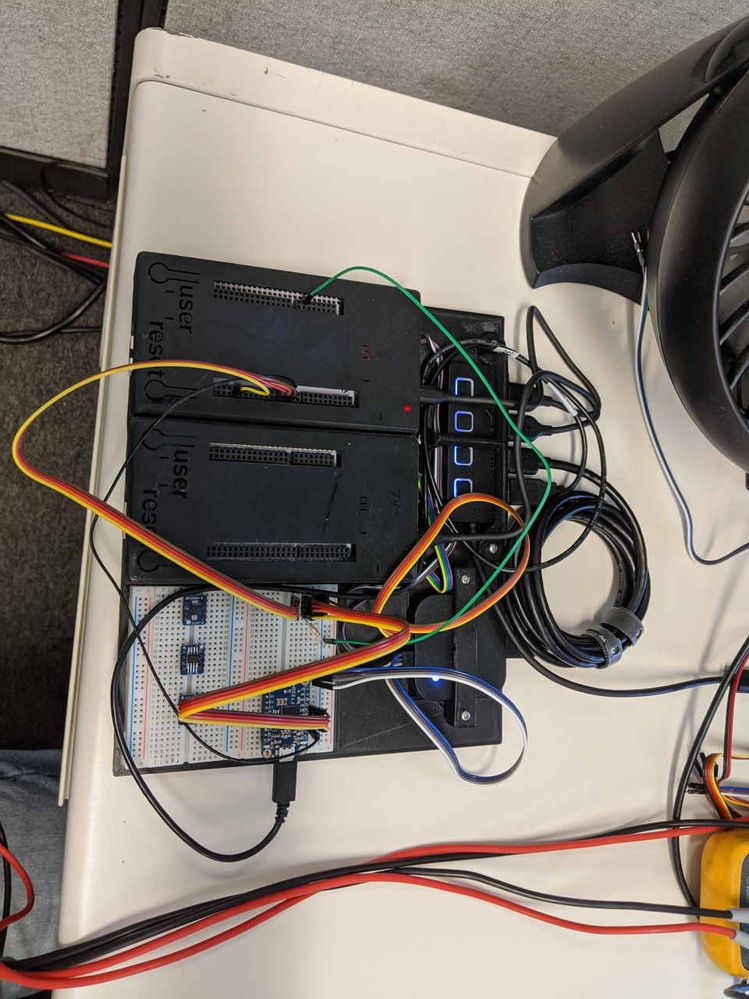

I have triple checked the connections and I am even using the same color coded breadboard jumper wires to verify everything is connected as represented below.
Connected to PE11, PE12, PE13, PE14 located on CN10. CN10 pins 6, 8, 10, 26.
CS | PE11 |CN10 Pin 6 | Channel 0
SCLK | PE12 |CN10 Pin 26 | Channel 3
MISO | PE13 |CN10 Pin 10 | Channel 2
MOSI | PE14 |CN10 Pin 8 | Channel 1
GND | GND |CN10 Pin 5 | Connected to FT232H ground

If you're connected to the bootloader over USB, the SPI connection will not work. Only one interface can be active at one time.
To get in through SPI, ensure no other interfaces are active during the initialization.
2020-12-09 10:02 AM
I have only plugged in the USB cable to see if DFU mode shows. For the SPI testing I only have the pins outlined above connected.

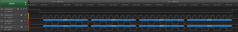

Here is my setup.

Seems like you're trying the right things. I've used the SPI bootloader before and never ran into issues.
One thing you could check is to use a different SPI port to see if you can get it working that way.
Edit:
Also, you're not following the proper protocol. You need to read a dummy byte between sending/receiving, see AN4286. But this would not explain the problem.

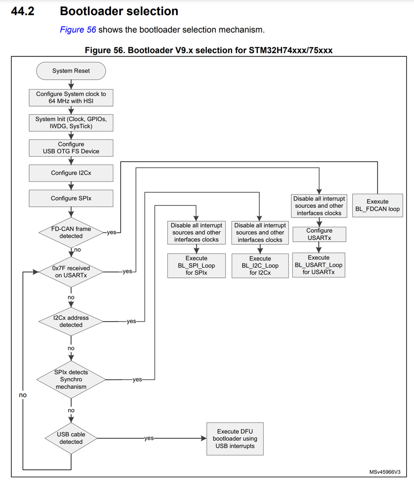

My next step is taking every pin that is an input while in the bootloader mode and using a pullup or pulldown resistor to fix it to verify no noise is tickling a pin to cause it to go into the wrong mode.
I am skeptical that this will fix anything as the USB DFU mode is the last thing to get checked as per Figure 56 in AN2606 Rev 46.

SP1 using PA4, PA5, PA6 and PA7 just returns 0x00 instead of 0xAA.
