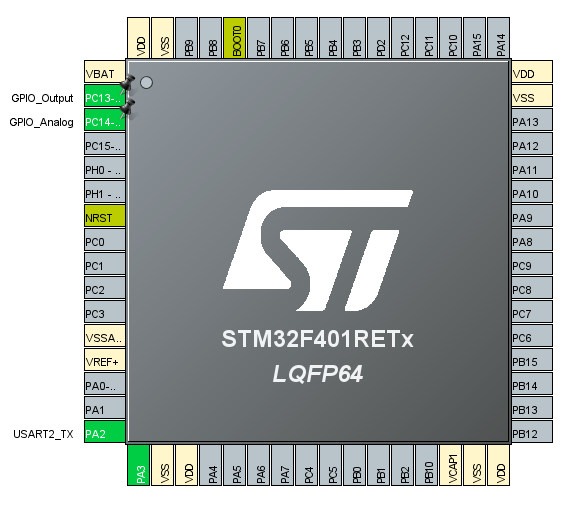

Well, it seems that we can't completely trust IS_GPIO_PIN or IS_GPIO_ALL_INSTANCE; see :
Here is my .ioc for the STM32F401RE project, as you can see there is no E or D port :
but if we check the stm32f401xe.h file where GPIO are defined, we see that PORTS E and D are defined :
and here is IS_GPIO_ALL_INSTANCE macro definition :
Did i miss something ? or does it just suck ?
Regards,
AJT
2020-03-03 1:31 AM
There are no distinct headers per package, so they inevitably cover the largest package in the given subfamily.
2020-03-03 1:34 AM
Ok, that what i was thinking. Thank you !
