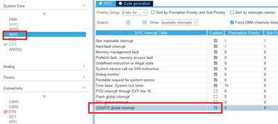

So it's not a limitation as you didn't activate the NVIC in CubeMx.
To let CubeMx generate the IRQ handler you need to enable it in NVIC menu:
