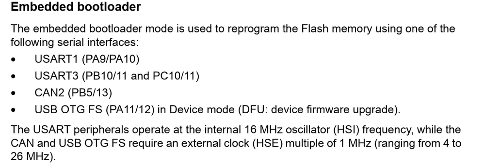

if you would look in the RM , you would see:
Is no CAN bootloader in STM32F103RBT6.
stm32F407 has:
