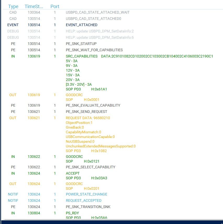

I am studying USB PD. I am using the demo board B-G474E-DPOW1 and the project from the STM32CubeG4 examples.
When I connect the USB-C cable to the charger, after the ATTACH event, I receive a list of possible profiles from Source.

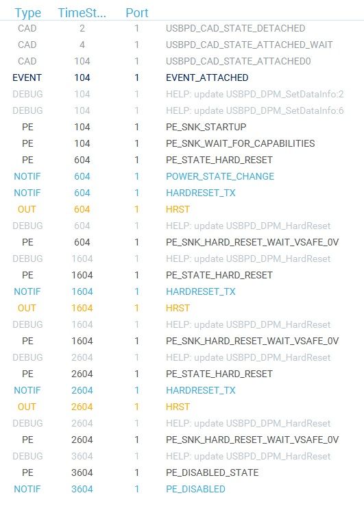

But when the cable is already connected to the charger and I reset the board, then after the ATTACH event, the list of profiles from Source does not come.
Is this normal behavior? Should source power profiles come only after cable connection?
How can I fix it so that after resetting the board, everything works same as on cable connection?

Dear @ADoro.2
when cable is already connected, source port is not able to detect that CC connection has been lost.
Then sink should send a hard reset to reset VBUS on source side and wait for new source capabilities.
Unfortunately, in the code you are using, there are no code to check that VBUS goes lower than Vsafe0V (around 750mV)
Can you add the following user code in the function 'USBPD_PWR_IF_SupplyReady'?

}In meanwhile, I detected with few chargers, that VBUS value by the disco board does not reach Vsafe0V. In my case lowest value was 1350mV.
Then, I needed to increase the threshold of 'USBPD_PWR_LOW_VBUS_THRESHOLD' to 1500mV.
#define USBPD_PWR_LOW_VBUS_THRESHOLD (1500U)In this case, I was able to receive correctly the new SRC capabilities after the hard reset:
84 PE 1787 1 PE_STATE_READY_WAIT
(board reset with attached cable)
86 CAD 4 1 USBPD_CAD_STATE_ATTACHED_WAIT
87 CAD 123 1 USBPD_CAD_STATE_ATTACHED
88 EVENT 123 1 EVENT_ATTACHED
93 PE 123 1 PE_SNK_STARTUP
94 PE 123 1 PE_SNK_WAIT_FOR_CAPABILITIES
95 PE 623 1 PE_STATE_HARD_RESET
96 NOTIF 623 1 POWER_STATE_CHANGE
97 NOTIF 623 1 HARDRESET_TX
98 OUT 623 1 HRST
101 PE 623 1 PE_SNK_HARD_RESET_WAIT_VSAFE_0V
(vSafe0V detected after 711ms, timeout set to 1s)
102 NOTIF 1334 1 POWER_STATE_CHANGE
106 NOTIF 1334 1 POWER_SNK_STOP
107 PE 1334 1 PE_SNK_HARD_RESET_WAIT
109 PE 1423 1 PE_SNK_WAIT_FOR_CAPABILITIES
110 IN 1573 1 SRC_CAPABILITIES DATA:2C9101082CD10200FAC00300C8B0040096400600 / 5V - 3A / 9V - 3A / 12V - 2.5A / 15V - 2A / 20V - 1.5A SOP PD3 H:0x51A1 I advice you to trace the VBUS value to confirm the vSafe0V:
