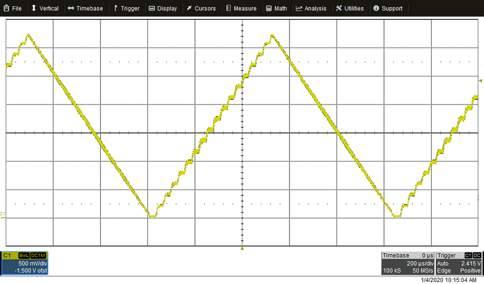

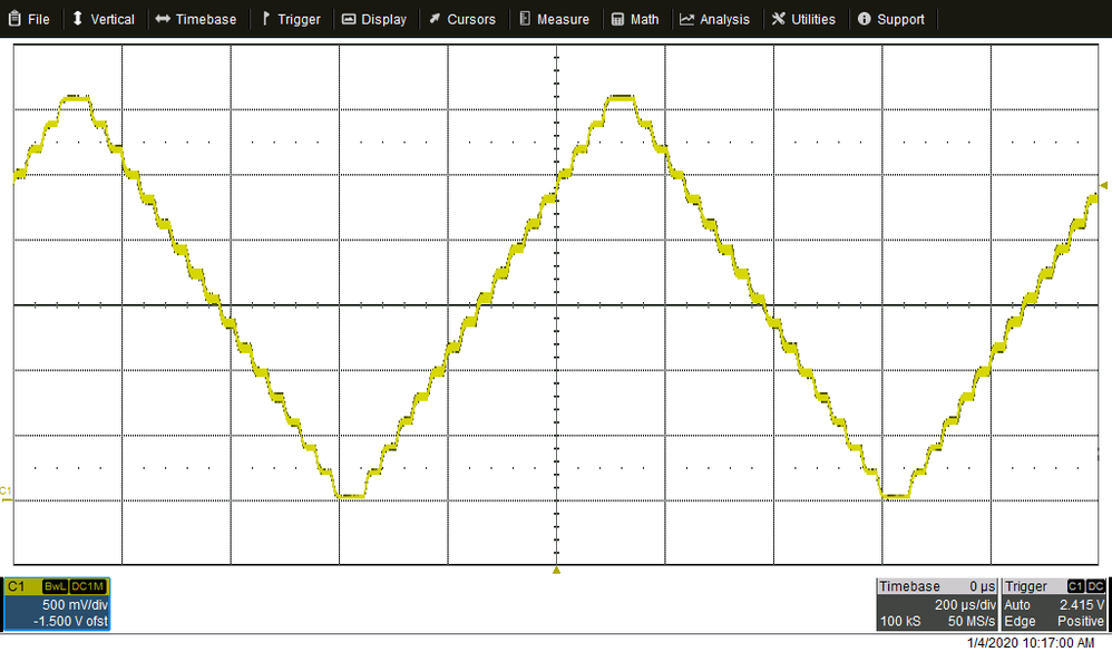

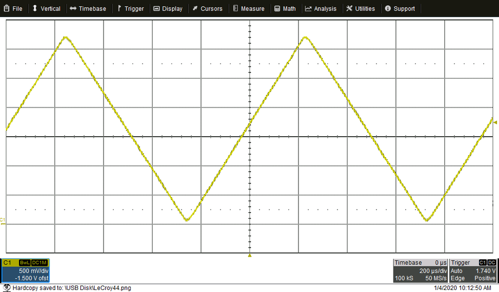

output when there is "DitherIndex" supplied to the function "UpdateDitherTable" at AA, BB, CC, DD places.
output when "0" placed instead of DitherIndex for AA and CC
output when "0" placed instead of DitherIndex for BB and DD
output when "0" placed instead of DitherIndex for AA,BB,CC and DD
