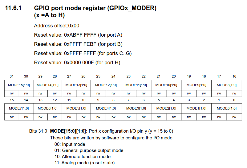

MODER9 reset value is not 0, please check the STM32L5 reference manual,
Perhaps you need to reset the 2 bits before setting the value to 1:
GPIOA->MODER &= ~(GPIO_MODER_MODE9_Msk);
GPIOA->MODER |= (1 << GPIO_MODER_MODE9_Pos);

I am not sure what my take-away from this is. I wonder if the designation of PA9 as output is happening correctly. The documentation says that the reset value of port A is 0xabffffff. The operation on line 15 in my code is seemingly a no-op in that case?
Thanks for any further assistance you can render me.
