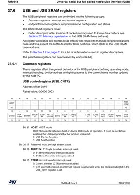

Maybe someone from ST can point me to some additional documentation for the USB peripheral and the PMA?
2024-06-15 7:24 AM
Dear @Nickelgrass ,
Full description of USB and PMA SRAMs is here :https://www.st.com/resource/en/reference_manual/rm0444-stm32g0x1-advanced-armbased-32bit-mcus-stmicroelectronics.pdf#page1262
Not an easy task to handle , all the processing should be interrupt based .Let us know

Thanks for the reply. I read the RM (of F042). But I somewhat hoped there was a more detailed explanation to the PMA. Something like a concrete map of what goes where.

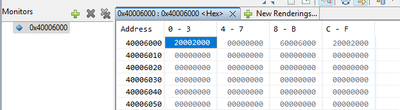

its been over a year since I posted first. After a few things got in the way today finally I got round to actually start implementing it. So far all is setup and I am debugging receiving packets.
It seems I am misunderstanding one detail. With BTABLE=0 I have set my control endpoint 0 ADDR_TX to 32 and COUNT_TX to 0. Then ADDR_RX to 96 and COUNT_RX to 64 which translates to 0x8800 with the NUM_BLOCK value 2<<10 and bit 15 set. I checked in the debugger that the values in the USB RAM are actually correct which seems to be the case. Note that the USB RAM is 16 bit wide, so the upper 16 bits of each 32 bit word are just a mirror garbage.
Now if I start the program I do receive the first two bytes of the first request. But the bytes are written to address 0 and not 96. If I change the COUNT_TX to some value, the data is stored at the address that COUNT_TX points to. I also tried simply using values that the Cube HID example uses. But it still results in rubbish. The request data is simply not stored. My endpoint 0 register is set to 0x3210 just like in Cube. Note that the value at address 0 are actually the first two bytes from the request 0x80 0x06. The 0xDDDDDDDD seems to be some strange garbage.
Does anyone have an idea what I am doing wrong?

Looks like you have some error in the code setting the endpoint buffer pointers. In F0, PMA content may be displayed incorrectly. It must be read and written as 8-bit or 16-bit but unlike in F1 both halfwords in every word are meaningful. You may try to compare your code with mine - link in the signature.
2025-09-07 1:50 AM - edited 2025-09-07 1:51 AM
As you've found out yourself, the device-only USB module bears significant 16-bit legacy, i.e. it has been originally built for 16-bit mcus. This is reflected not only in the access to its registers, but also to the memory buffer, which does not allow other than 16-bit access. Thus, what Cube displays when reading it as 32-bit words, may be and most probably also is incorrect.

Thanks to gbm and JW! It works now. I had some screw ups in my addressing. My biggest mistake was using 32bit pointers and taking in account the wrong addressing like in F1 series.
