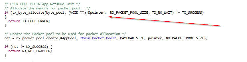

Dear @Walid ZRELLI ,
thanks for checking this topic again. This answers my question almost complete. The only thing I would like to know is if there is an example how to separate the buffers.
As I understand NetXDuo all packets (TCP & UDP) are put into the "packet pool".
Best regards,
Eric
