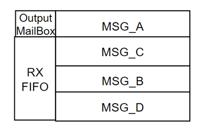

Suppose 4 CAN data frames arrived and they were all stored into FIFO1. Then CPU wrote 1 to RFOM1 for 4 times. This procedure is showed in figure1.

1.The mailbox and 3-level FIFO(Only FIFO1 is used and FIFO0 is excluded in our discussion.) can store up to four different data frames.
2.At t1, FMP1[1:0] in CAN_RF1R is 11b.    FULL1 is 1.
The message distribution should seem like figure2.
figure 2
3. At t2, FMP1[1:0] in CAN_RF1R is 11b.    FULL1 is 1.
The message distribution should seem like figure3.
figure 3
 4.After t3, FMP1[1:0] in CAN_RF1R is 11b.     FULL1 is 1.
The message distribution should seem like figure4.
figure 4
