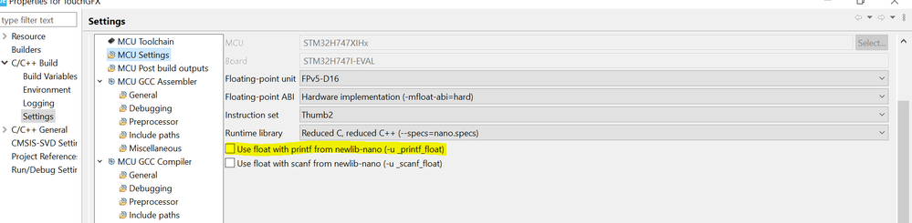

Hello @EthanMankins
Please ensure that you are enabling the use of floating point with printf in your STM32CubeIDE project.
