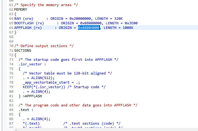

Hi, I am writing my bootloader, I changed MSP and reset handler value correctly so code is able to got application mode.
In my application I changed VTOR value as below but still my application is getting stuck post sending data to UART.
I am using STM workbench IDE so when I try to debug application code, its erasing bootloader code so I am unable to check exact reason of failure. Any suggestion as code looks fine to me.

Btw Did u find anything wrong in shared code images?

Your selective images didn't really provide much insight into what instructions the processor executed, or where it "crashed".
You need to focus on the point of failure, and work backward from there.
