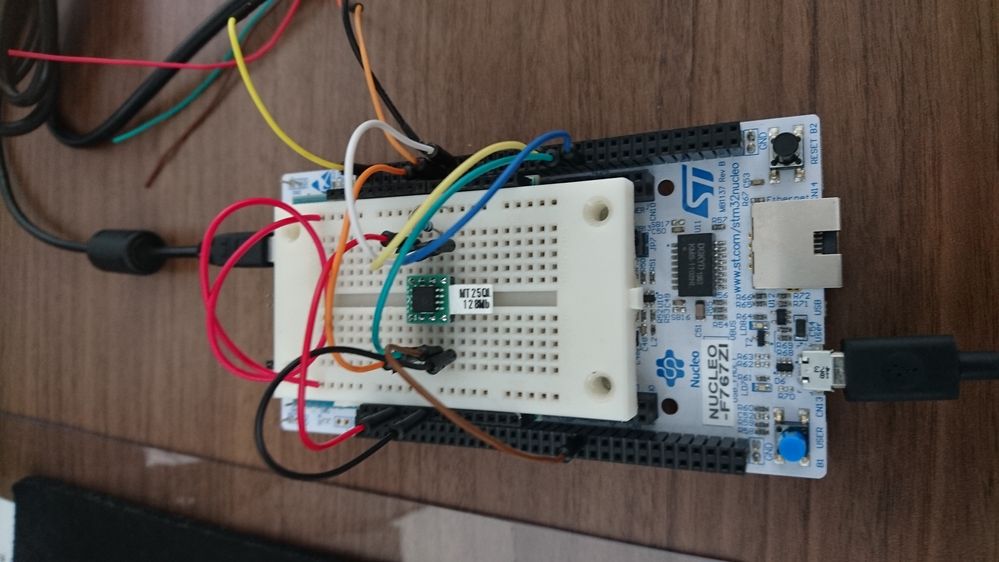

I am making a USB MASS STORAGE program.
It is recognized by Windows10 and can be used as a drive after formatting.
I was able to copy the file and open it correctly.
However, when I reset the NUCLEO board, windows prompts me to format it again.
I don't know Why?
I use NUCLEO-F767ZI board, and MT25QL128 FLASH (QSPI mode).
Thank you in advance.

I tested it with a simple program to see the basic reads and writes.
After writing the data to FLASH, when I compared it with the read data, they all matched.
So I think both writing and reading are working properly.
However, it will fail unless the clock rate is lowered.
Is there a hardware problem?
