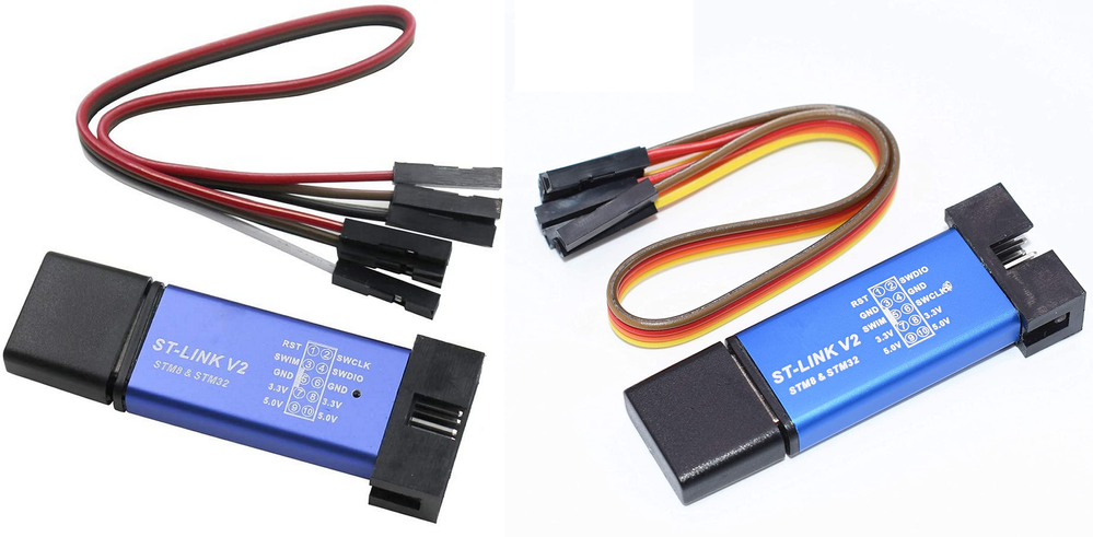

Another thing is that there's no standard pinout, and it does vary!! :o
So, if you've got more than one, it's possible that they have different pinouts - which could cause damage...
Here's an example - look carefully at the pinout legends on these two:
