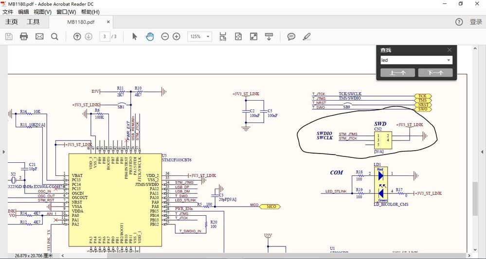

I noticed the SWD CN2 Header reserved on the board, but I do not know how to use it. You did not reserved the selection 0 Ohm resistor or jumper. But I do think you leave it alive for some use ? I checked with oscilloscope, when I download program to the MCU, no wave form.

Now I know that the SWD header connected to the st-link MCU SW pins. Thats why I can not measure waveform when loading program into the main MCU. But still have question for what should I do if I want to use Nucleo 32 board stlink part to write program on external MCU Stm32L432KC ?
