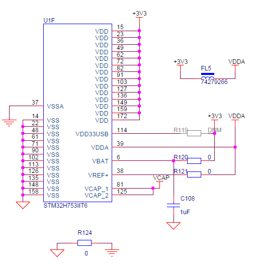

Hope the image is readable, looks shrinked.
VREF+ and VDDA are tied together and derived from +3V3 via an EMI filter, without any capacitor.
I will test with a capacitor added.
2022-04-12 2:40 AM
The VDDA/VREF+ pins actually had capacitors, they were in another corner of the circuit diagram:
I have tested with and without the EMI filter and I have shorted VREF+ and VDDA to each other on the MCU pins, no change. The PCB layout looks
quite airight, no long tracks etc.

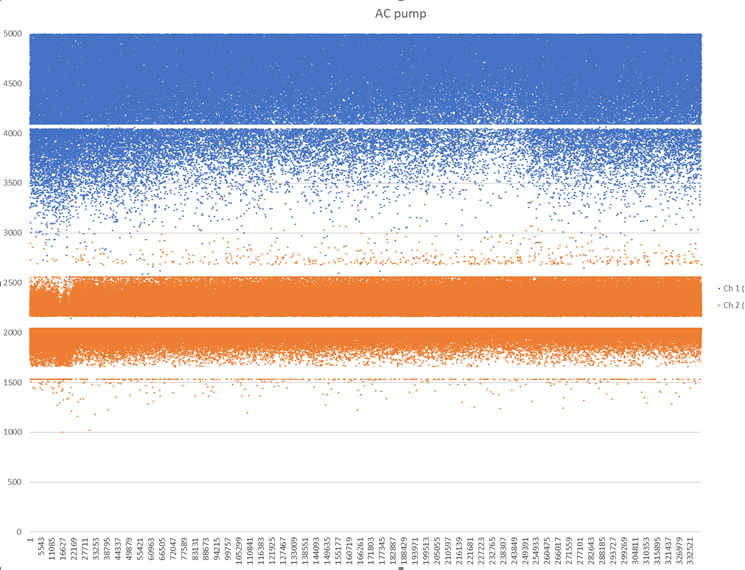

ADC data gaps:
The above image shows data from ADC1 (blue) and ADC2 (orange). A/D values on Y axis.
The horizontal white stripes thus representing gaps in ADC data.
The ADC1 graph shows gaps at 4k intervals (it continues at 8191, 12287 and so on) but the ADC2 graph
shows intervals of 512 and there are nearly 25% of "dead" values for the orange plot.
This data comes from a third unit I tested, and fact is that all three differ in behaviour even if they run the same program.
The other two does not display any dead data for ADC2, but they differ in the ADC1 interval; one has 4k intervals the other has 16k intervals.
So the problem seems to differ between different MCU units.
Building on the above, I'm shifting focus towards the ADC setup.
