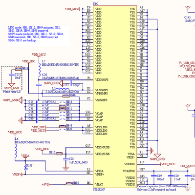

If I am stuck using only the LDO setting (not using either SMPS powers LDO settings) then I know from the schematic that I need to change several solder bridges.

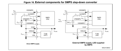

from ds:
On your disco board its wired for max. eff. , so ldo unused. Do not try to set anything else in Cube ! (at this state of disco board ).
IF you want check it at max. speed, change the solder bridges on the disco board to smps->ldo -> core.
(in blue text in pic ...but check, if all seems ok.)
And make a new project in Cube, not starting with H747-disco (board), but just (as in your future product) H747XI (cpu) project. Here you can set the smps->ldo mode and run the chip at 480M.

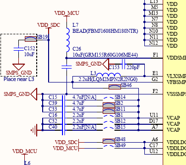

OK, so what I understand is that I can use the internal SMPS to power the LDO so that I get smooth (low ripple) power to the core (smps -> ldo -> core) and then can run the core at 480 MHz. I just need to make the jumper (solder bridge) changes on the discovery board to route the SMPS to the LDO and disconnect from VCAP pins.
Looking at the datasheet figure 16 and the disco schematic:
It looks like those are the only solder bridges to change to connect output of SMPS to input of LDO. Any other solder bridge changes would disconnect the SMPS (rendering it useless) and only power the LDO from the main VDD into the board. Disconnecting SB19 would remove the SMPS output cap unstabilizing the SMPS and disconnecting SB48 would completely disconnect the SMPS from the LDO. Does that all sound correct?
To me figure 16 (second diagram) makes it look like VDD_External is another external power supply feeding the the SMPS along with the main board VDD feeding the SMPS. Or is it trying to show that the SMPS can supply power externally?

You have to separate the vcap from smps ! -> remove sb46 !! add c152 + sb19 (if not there)- check.
But double check: not to supply/connect core (VCAP pins) with SMPS any more ! You kill the cpu then.
check this and the connections you made with DMM for good contact - before apply any power !

AScha.3, I am accepting you last reply as the solution. I only had to remove the SB46 as C52 and SB19 were already on the board.
