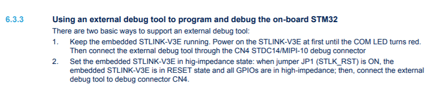

Adding some additional notes:
This is in the UM2505 Manual on the G431 Nucleo board:
#1 does work but the j-tag see's two devices, the G431 and an "unknown"
#2 does NOT work. With JP1 in place there is no +3.3V at CN4-3 (Vt).
Is +3.3V at CN4-3 supplied from the SEGGER debugger, or is it just sampled? If sampled, where is +3.3V sourced from?

Answering my own question,
With the JP1 reset jumper in place I don't think the +3.3 supply gets the enable signal from the ST-LINK MCU.
I changed the JP5 jumper to +5V_CHRGR and left JP1 with the reset. Now both MCU's power up. The J-Tag still only recognizes one MCU however. As a note the J-Tag see's two devices in that MCU which I understand is the M4 core and the FPU. So chaining two G431 MCU's should result in seeing 4 J-Tag devices.
