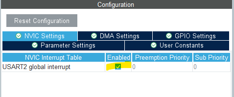

USART receive is not providing the output please check and reply me asap
selected USART2 made it to asynchronous also enabled global interrupt
code lines that i have added

Hello @soundarya_h_s ,
If you using the interrupt mode, the transmit and receive functions are HAL_UART_Transmit_IT() and HAL_UART_Receive_IT(). For that, I recommend you to take a look to this FAQ: How to use STM32 HAL UART driver API and Callbacks ?
Also, I think Getting started with UART can help you.

@KDJEM.1 i tried disabling the global interrupt but i am not getting output
2023-11-08 10:28 PM
HAL_UART_RxCpltCallback only works when interrupt is enabled. HAL_UART_Receive is only polling and will not trigger an interrupt callback. If you want polling then you have to rewrite your code to transmit what you received.

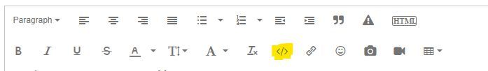

Use code sample so we can see formatted code to make it easier to read
