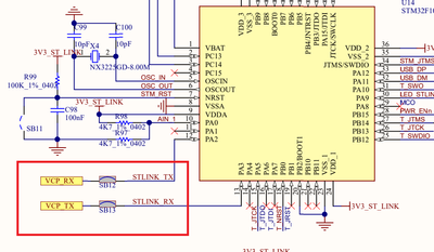

As you are using STM32F7508-DK board and using TeraTerm, you didn't mention how you did the connection from the board to the PC?
With this board you need to use USART1 (PB7: USART1_Rx, PA9: USART1_TX).
According to the schematics:
ST-LINK will be used as a virtual comport between the MCU and your PC.
