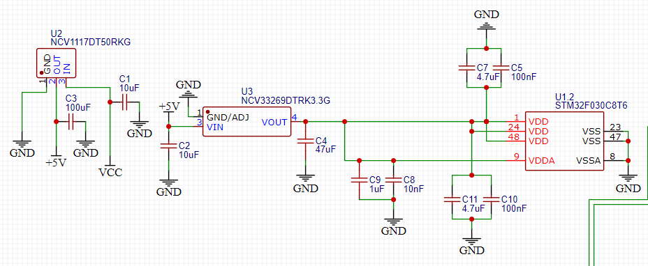

Also, I've checked the schematics, the power is well connected as you can see here :

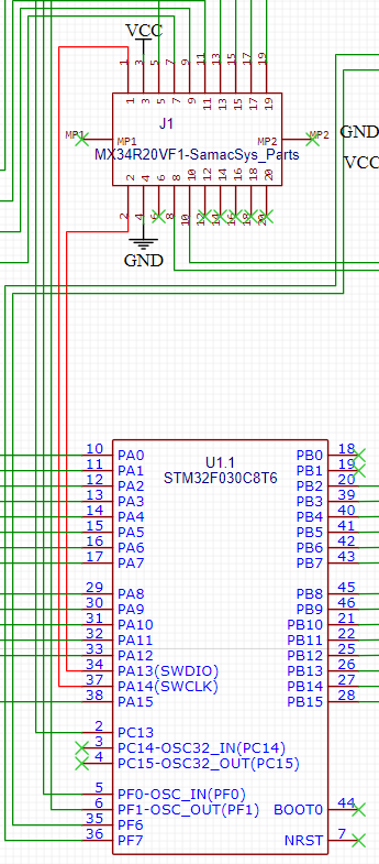

The SWD and SWCLK are connected to an external connector :
Then I have the power from a power supply with 3.3V.

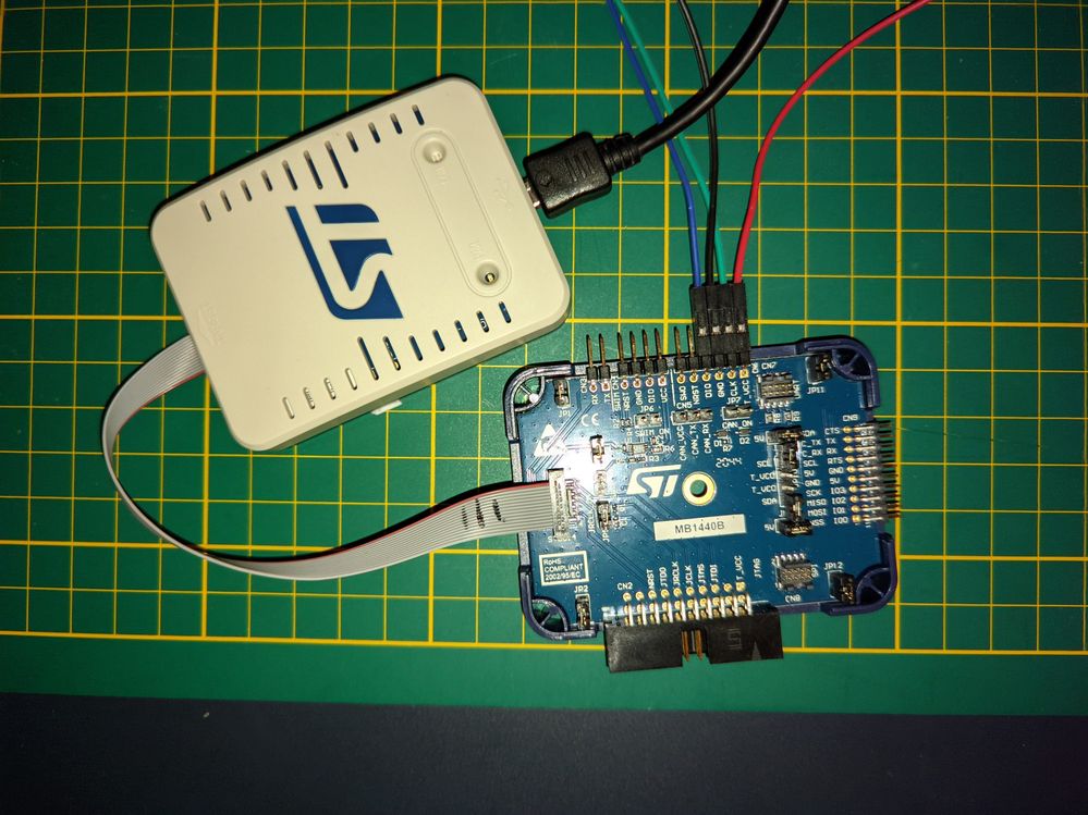

I've connected this way to the ST Link :
Red : 3.3V
Green : SWCLK
Black : Ground
Blue : SWD

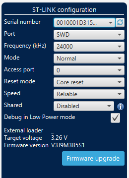

As for the software I'm using STM32CubeProgrammer
Here is the config and you can see the 3.3V is read :
And when I press connect I've got this message :
What can I try ?

>>What can I try ?
Try a lower connection rate, 24 MHz is typically too high for CM0(+) devices, start with 2 MHz
Typically SWCLK,SWDIO and NRST are suggested.
A device that is not electrically functional will not respond.
Check NRST is normally HIGH, pulled-up internally
Check power on VDD/VDDA
Check part orientation
Check pin assignments and netlist
BOOT0 is typically pulled LOW externally so the part runs User Code properly out of reset.
