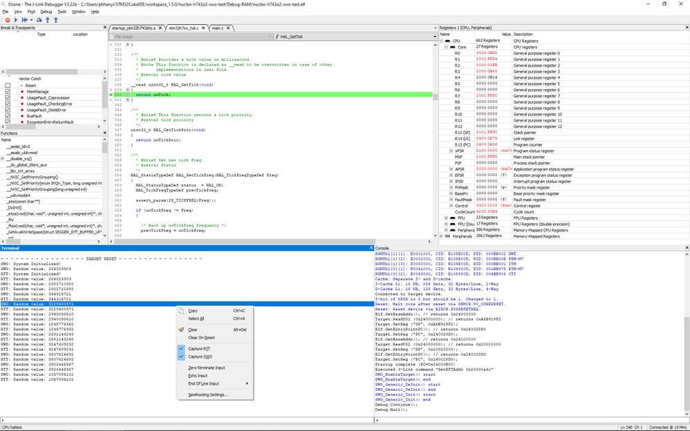

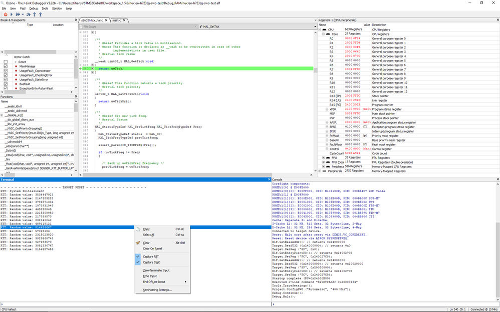

I extended both projects with SEGGER RTT printf and tried to debug with Ozone:Only RTT is visible with NUCLEO-H723ZG, SWO also works with NUCLEO-H743ZI2.

I attach the two .elf files, both loaded into RAM.

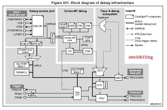

The H743 was originally conceived as a dual core device, there is a lot of clutter and complexity in there related to that. The H723 is likely a cleaner single core implementation. Expect it to have subtly different registers and plumbing.
There isn't a SWTF also
Expect different DBGMCU registers, addresses and units. Would definitely suggest unpacking the ROM Tables and seeing exactly what units/options where implemented.

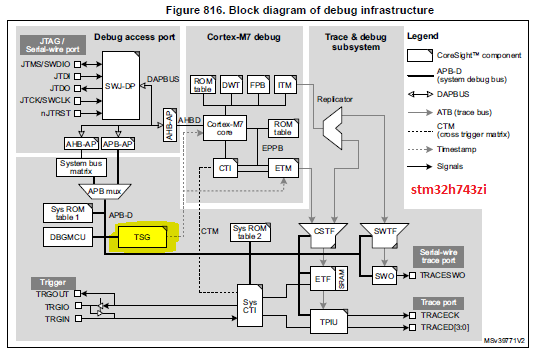

The debug infrastructure block diagram shows that TSG is missing from STM32H723ZG.
There are other differences too. Can these differences cause that problem?
