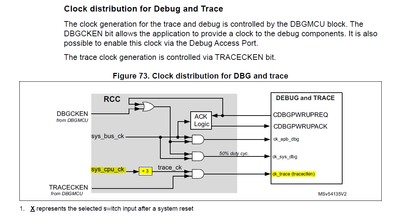

To answer my own question: We figured it out.
The MHZ in the debugger are not the CPUCLK, but the clock speed of the debug interface: trace_ck.
The information can be found in the clock tree or on description of the clock distribution for Debug and Trace.
