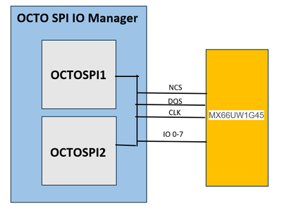

In STM32U5A9J-DK the OCTO SPI IO manager has two OCTOSPIs instances (OCTOSPIs Host controller) OCTOSPI1 and OCTOSPI2 and both of them shares the same IO lines in multiplexed mode . In RWW mode we need to have two octo spi host controller (OCTOSPI1, OCTOSPI2) and both of them can access the HAL driver in parallel to perform read and write on the external flash. I have attached one image here for your reference , please correct me if my understanding is wrong.
Do you have a RWW example for STM32U5A9J-DK which uses OCTO SPI interface , this will be a great help.
