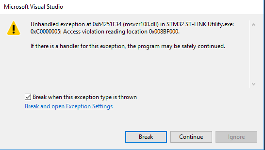

The Cube package seems to have no binaries. I haven't get up to speed how to compile code and don't have plan to spend lot of $ yet on a development toolchain because I am just evaluating the STM32 right now. I thought, just to download the binary would be quicker but the tools crashed (tried another Win10 system and the same thing happened)

Maybe a bit late to this, but which version are you using?
A colleague tried to use the STLink Utility v3.8.0 with a new Win-8 HP Laptop, and the utility would always crash on 'Connect to Target'.v3.7.0 had no problems on a (nominally) identical Win-8 HP Laptop.v3.8.0 could be made to work by setting Windows Compatibility settings for XP-SP3.Maybe that helps someone ...We’re moving the ST Community to a new platform to give you a better and more reliable community experience.
