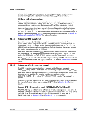

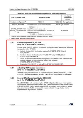

I don't use the 'U5 nor CubeMX, but "stuck in core reset" usually means, that given peripheral does not have clock. In the high-end 'U5 and OTG_HS, setting up clocks is a nontrivial process.
In the 'U5 there are additional obstacles to getting USB going in form of separate power supply pins and their isolation switches.
2024-11-11 5:46 AM

Thanks for your advice, it was helpful, and I was able to solve one of my issues.
By adding a function __HAL_RCC_SYSCFG_CLK_ENABLE() ; in the System Clock Configuration function SystemClock_Config() ; , I was able to exit from the
static HAL_StatusTypeDef USB_CoreReset(USB_OTG_GlobalTypeDef *USBx); function successfully.
However, I'm still facing an issue where the USB device is not being recognized by the host (not visible in Device Manager). I've attached my project .zip file, including the .ioc configuration file. I would appreciate any guidance on resolving this USB recognition issue. Specifically, I am not sure if there might be a problem with the USB initialization or descriptor configuration. Any insights or suggestions would be helpful.
