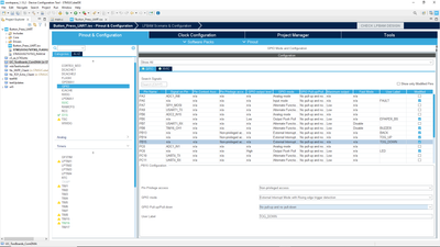

2025-02-05 8:22 AM
I took your .ioc and created a new project.
This is how your GPIO are setup.
There is no pull up selected and inputs are driving interupts !
Any noise is detected.
These inputs acr CMOS, that means that they can take any state (thanks to internal capacitative coupling) of any internal register or signal line.

2025-02-04 5:27 PM
Hi mbarg,
Attached the IOC file as suggested.
IDE Version used is IDE 1.16.0
The issue is with Tog_down_sw. it is in floating state even when pulled up both internally and externally (no other passive components inbetween). when tog_up_sw is pressed tog_down_sw goes low.
please list the possible cause.
2025-02-05 8:22 AM

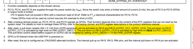

2025-02-06 10:43 PM
The issue is resolved by setting UCPD_DBDIS = 1 in the PWR_UCPDR register.
By default, in reset mode, it behaves like the above way I mentioned. Now it works good
As mentioned in the datasheet.,
Thanks for the help!!!!
