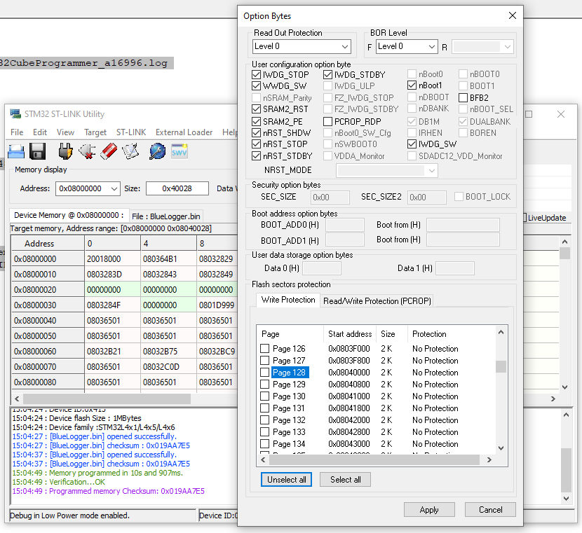

Shutting down...STM32 ST-LINK Utility loaded the same bin file without error.
The STM32L476 should have 1MB flash, and I've used just over1/4 of it.

Thank you so much. Your instructions fixed it.
STM32 ST-LINK Utility showed that I had:
STM32+STM8 Debugger
V2.J37.S7
I reflashed my st-link V2 even though it was the newest firmware.
Then download the newest STM32CubeProgrammer 2.10, installed it, and followed the following instructions to integrate it into TrueStudio:
