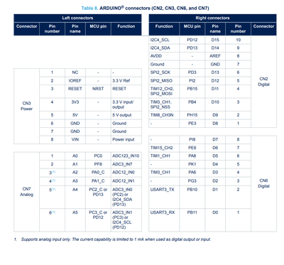

Does anyone have the link to the schematic of stm32h750b-dk. I'm new to this world but I found the schematic for other boards. By schematic I mean the correspondence between the name of the pins as marked on the board and the "internal" name that is used to access that pin in the CubeMX. For example, for stm32f7 I can see that D0 correspondes to PC7, D7 to PI3, etc.

Schematics for this board are available under schematic pack in this link (MB1381). Also, for pin naming, you can have a look at the UM2488.

I'm not sure about your request but the Arduino connector pin description is provided in the user manual of the board UM2488: /Table 8:

It did. Thank you so much!
