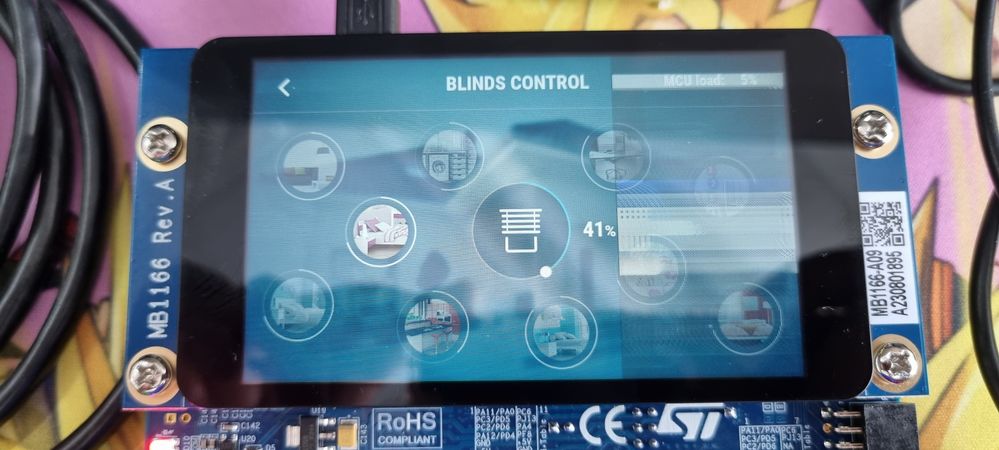

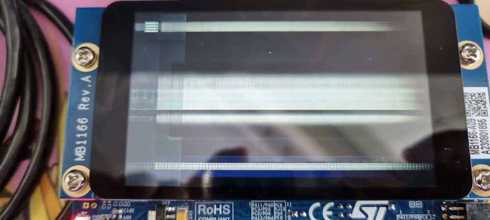

I bought an STM32H747I-DISCO, and installed the TouchGFX demo software.
When I turned on the board, the demonstration ran perfectly on the LCD display, but after a few seconds, the images on the display started to show problems, as shown in the photos.
If I disconnect and connect the USB cable, the problem continues, but if I disconnect and wait a few minutes, and turn it on again, the display starts perfectly and after a few seconds the problem appears again.
I'm using St-Link v3 USB power.
Has anyone had this problem?
Thanks!

2024-02-23 9:31 AM
It could be an issue related to the LCD.
If you have a chance to have another LCD, could you please do a test with it?
2024-02-23 9:34 AM
I have another one in the box. I will open it to test.
I'll let you know the result soon.
Thanks,
Jr

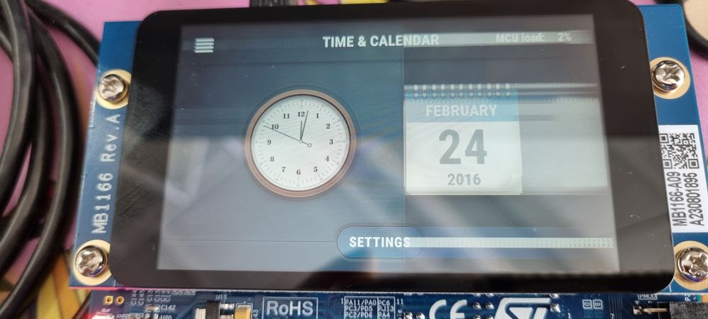

2024-02-26 9:27 AM
Dear @mƎALLEm ,
I tested a brand new STM32H747I-DISCO board, opened the box, and installed the TouchGFX demo software again.
I had a similar problem, but this time it took about 1 minute for the defect to appear.
As I bought the 2 boards at the same time from Digikey.com, I believe the problem could be the LCD batch, what do you think?
This new LCD has serial number: MB1166-A09 A23080445
Can I buy just the LCD to change the boards? Could you tell me the model and if I can find it on Mouser.com or Digikey.com?
Have a good day!
Thanks,
Jr

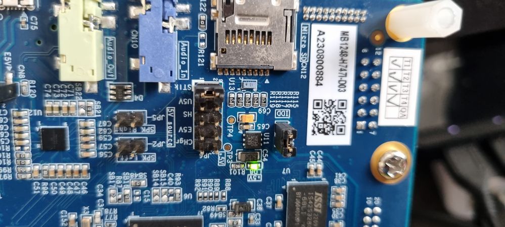

Hey guys - Just picked up a STM32H747I-DISCO board from Digikey and having an issue. As delivered, LCD is non-functional. In the past when I've had similar boards, they were running the demo software out of the box. I removed and re-installed the LCD just in case something had come loose during shipping. Also as a pre-caution, just in case it didn't get programmed, I flashed it with the software binary from ST's site. LCD still non-functioning. LCD module is a MB1166-A09 with SN A230900038.
Software on the main board seems to be running. When I plug it into a PC, it enumerates and has a file system available. Also, since i was able to program it that seems functional.
How do I go about getting this resolved? Get it exchanged thru Digikey? Thanks,
Keith
