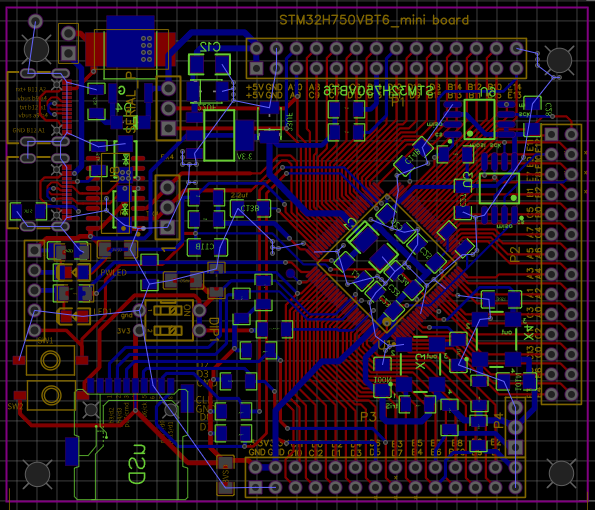

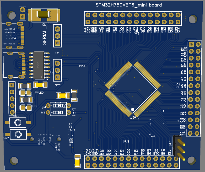

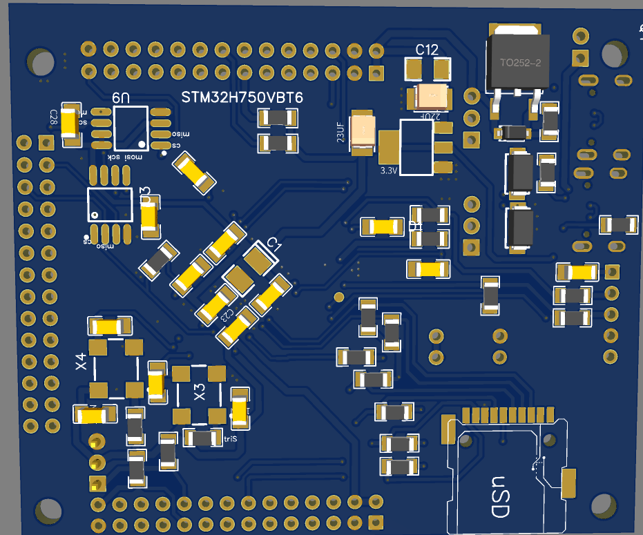

2024-08-06 2:25 AM
Thanks DeLorean
Here is my pcb design
It's my first stm32 pcb sure that it's not perfect because i am learning i am comming from esp32 world that is really more simple.
I have faced some problems with clock ic at the begining because i have buy by mistake 3 states clock(with no data sheet Aliexpress is not perfect.but it's affordable..) and not crystal. (but achieve to make it work).
- QSPI and Spi flash are working perfect i have follow Controltech tuto on youtube and all result was good.
- what value of resistor do you recommand for input pullup on stm32h750 pins ?
