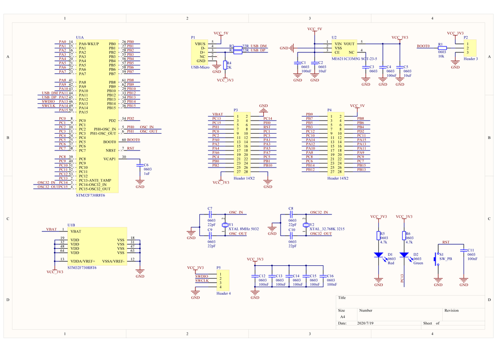

I've a stm32f730r8t6 core board, I need to use stm32 as USB HS device, looks like STM32CubeMX generate the code have bugs.
If using USB_FS is working fine but USB_HS is not.
I've traced the code failed at USB_CoreReset.

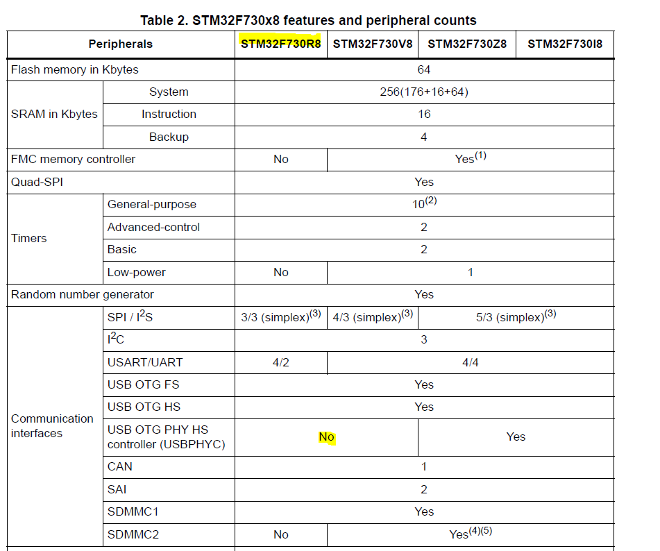

Sorry, I look datasheed again, R serial dones't support internal HS phy.(I didn't connect any external phy.)

It is difficult to answer, without seeing the .ioc file. or the source code, but
one thing I can see is that USB HS pins are not connected to any USB connector.
They are normally PB14 and PB15 for the USB HS block.
