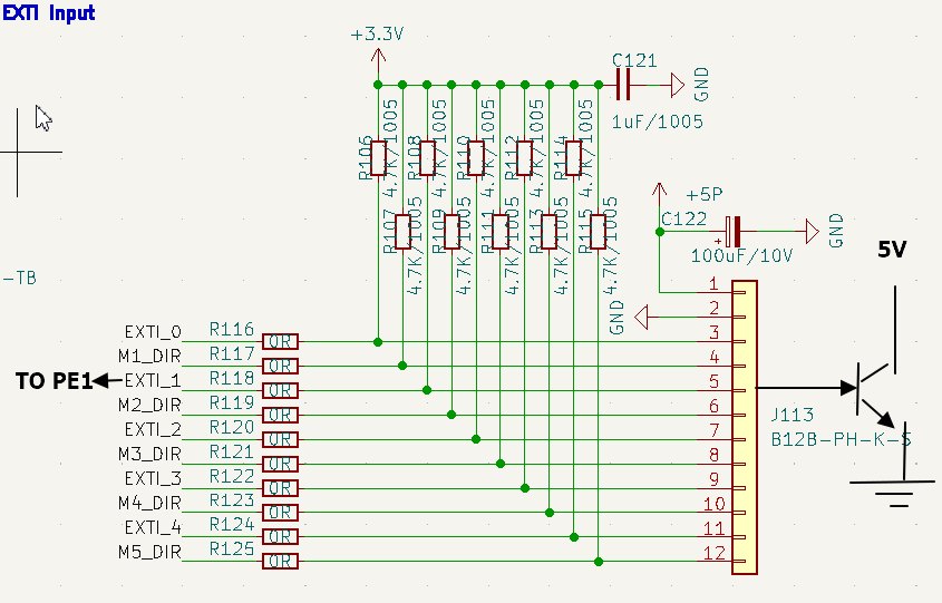

2023-04-26 6:07 AM - edited 2023-11-20 7:06 AM
The limit switch is working with 5V and PE1 is connected as below.
All other pins works just fine.
I don't know why this pin doesn't even trigger an ISR and simply reset the MCU as if it is like NRST pin.
2023-04-26 6:41 AM
Short between PE1 and neighbouring PDR_ON pin?

2023-04-26 4:46 PM
I checked the design and found PDR_ON pin near the PE1 left un-connected but there's no short between them.
Is it possible they can become somehow shorted together after power on?

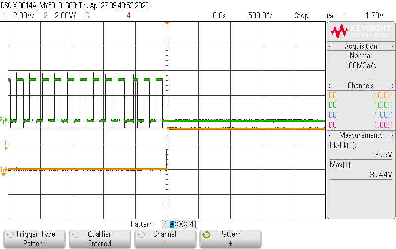

2023-04-26 5:47 PM - edited 2023-11-20 7:06 AM
Please take a look at below output.
CH1(Yello) is hooked up to the PE1 pin
CH2 (Green) is hooked up to a gpio toggle from the program.
As soon as the PE1 pin goes high(the limit sensor is cleared), the toggle output stops.
After a one or two seconds the program restarts again.

2023-04-26 11:18 PM
So it's PE1 going HIGH that seems to be the trouble, not LOW.
