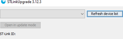

I restart computer and also uninstall and install driver st-link v2 but. doesn't change anything.
Power Led and LD8 led always on.
I found something : "LD8 (red LED) indicates an over-current from connected device", is this related my issue ?
