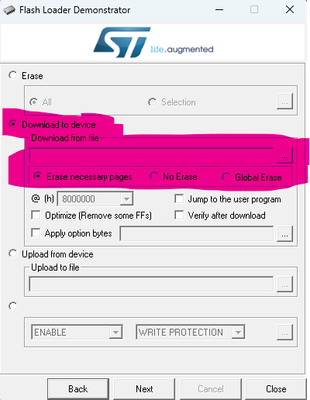

The board successfully bootloads and I can upload code via my ST-LINK and pogo pin header, but I'm not sure how to get the device recognized as an STM32 board, currently under my device manager its listed as a "USB Serial Port (COM4)". I found this video: https://www.youtube.com/watch?v=wGbiT6IxGP0&t=302s that shows how to install the STM32 USB bootloader, however, I don't know what file to download to the device. The device is recognized under the Flash Loader demonstrator, but here is the step I get stuck at:
What do I put for the part highlighted in red? My UART IC is communicating with the USB connector since I could get to this step but couldn't find a proper driver for the STM32F030F4P6.

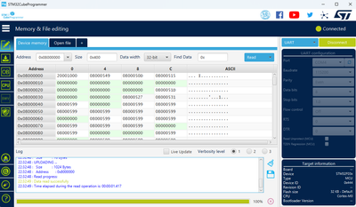

To upload code via the UART bootloader, boot into the bootloader by holding BOOT0 high during reset, use STM32CubeProgrammer, then select UART and the COM port it's connected to.
You're using an FT230X chip, which is a UART to USB device. It's going to appear as a generic serial port, but that's not a problem for anything.
Why not continue to use SWD to debug/program the board?
The bootloader on the STM32 resides in ROM. It is not something that needs to be installed--it is always there. Sometimes, users install custom bootloaders, but that is different from the system bootloader.

The device was able to be read in the STM32Cube Programmer which is a good sign:
But now how do I upload code directly in Cube IDE via USB? or is that not possible with the given UART ic I selected?
