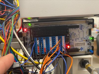

Hi, recently I have had a overcurrent issue with my old stm32 Nucleo H7a3zi-q board, so I replaced it with a spare identical to the previous board, but now I am having two new issue.
One is that when I connect the reset pin to an external trigger with the external trigger not being power (I checked with a multimeter), it give me this fault as shown below.
I have no idea what is wrong, so I unplugged the external trigger since it is not essential to the overall function. After I removed it, the program seems to be uploaded onto the board.
But afterward, I went over to check on the COM LED. it remains red. And when I try to trigger one of the functions linked to the stm32 via computer gui, the function does not work. So now i am thinking that the program was not downloaded onto the board even though the console tells me that it downloaded successfully. Please let me know if yall have any ideas.
2024-04-12 10:34 AM
Your external trigger apparently is constantly triggering. Some issue there? Grounding? Circuit implementation?
Perhaps you need some better output of diagnostics / telemetry so you have some idea as to what is and what isn't functioning on your board / software.
Perhaps have HardFault_Handler() and Error_Handler() set LEDs in specific ways, and perhaps toggle others.
Have a signs-of-life LED indicating a functional heart-beat, perhaps one in your main loop, and another in a SysTick driven handler.
Download and VERIFY with STM32 Cube Programmer.
Start debugging..
