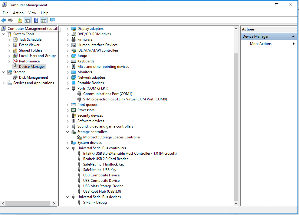

2019-01-05 6:17 PM
It is not my experience that parts magically erase.
Just saying a write to the mbed MSC might precipitate an erase. Current ST-LINK firmware is V2J32
2019-01-05 6:38 PM
yes. current ST-LINK firmware is V2J32M. And when I connect my board, driver connect such as image below. I don't know there is any software writing to Mbed MSC as you say
