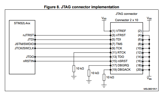

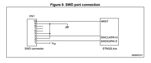

Posted on January 16, 2017 at 12:35
Hi
Heil.R
Please verify yourJTAG & SWDconnector implementation referring toPinout and debug port pins section on the
http://www.st.com/content/ccc/resource/technical/document/application_note/group0/93/81/9b/8d/2f/09/4a/e8/DM00125306/files/DM00125pdf/jcr:content/translations/en.DM00125pdf
-Nesrine-
