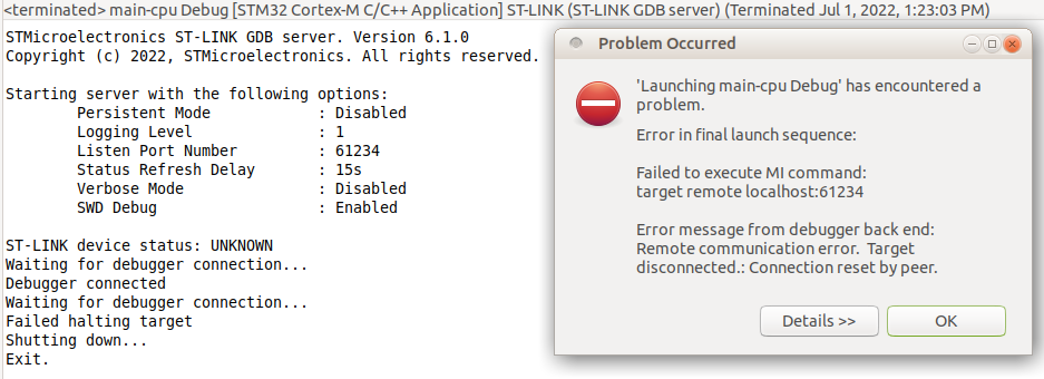

In some situations, CubeIDE (v1.9.0) is not anymore able to handle the communication with the ST-Link probe. Disconnecting the USB cable, restarting CubeIDE, reseting the MCU, nothing allows to make it working again. The only way I found is restarding the computer, which is a bit tedious.
Does somebody have a solution for that?
2022-07-01 5:04 AM
oupps, sorry, my fault, the MCU was held in reset by an external device
