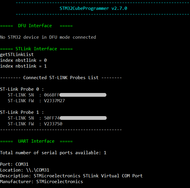

2021-05-04 12:03 AM
ST-LINK_CLI only supports JTAG and SWD, which can be listed using the command line switch -List.
STM32_Programmer_CLI connects via UART, USB, SPI, I2C or CAN. The list command lists at least DFU, SWD and UART connected devices, so maybe the footnote at UM2237, section 3.2.9, should be updated. I've attached an example screenshot of two connected boards with ST-LINK/V2-1 (nbstlink=0...1), one of which offers a virtual COM port, which is also listed:
Regards
/Peter
