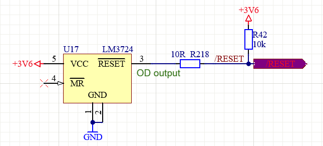

We connected by mistake PDR_ON to GND while we drive the NRST with an external voltage monitor as in the picture.

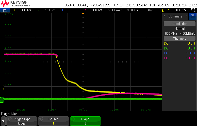

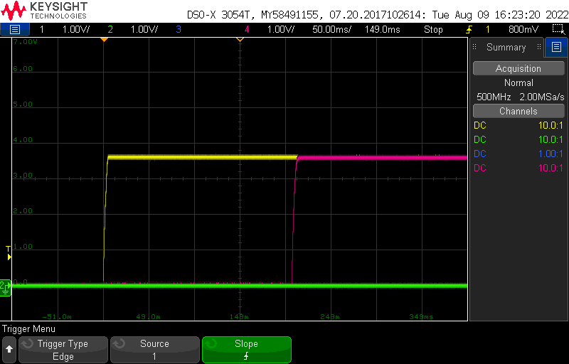

0693W00000QNI1CQAX.pngreset circuit to NRST0693W00000QNI1lQAH.pngPower up0693W00000QNI25QAH.pngPower down
Yellow -> 3.6, Purple -> Reset, Green-> PDR_ON
