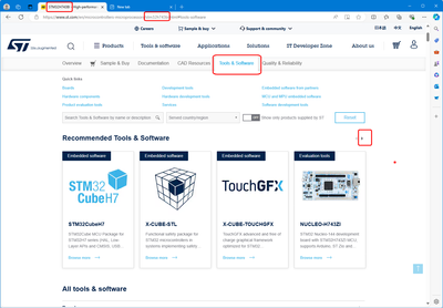

@AkshayMR wrote:Which is the development board that we need to buy and use for this microcontroller for prototyping and development purpose? Can we use STM32H753I-EVAL2?
You can always answer that question by going to the Product Page for the chip in question, and looking on the 'Tools & Software' tab:
https://www.st.com/en/microcontrollers-microprocessors/stm32h743bi.html#tools-software

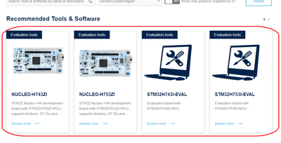

In this case, you will see four boards listed - which do, indeed, include the STM32H753I-EVAL2:
