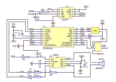

I need to modify this schematic, I want to use one USB connection connected to an STM32.
- When the STM32 is on Bootloader mode, A virtual com port will be open and I should have an option to save a mp3 file inside the external flash (GD25P32)
- When the STM32 is on App mode, I should be able to play some audio.
Is this possible? (Right now on this schematic the USB is connected to the WT2003 chip)

You can do whatever you code for. You can make it appear as a CDC or MSC, or both..

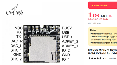

why not use the "standard mp3 module" , that can play mp3 ... ?
2024-05-05 6:26 AM
I don't want to use a uSD to store my file.... I prefer to use a external flash
2024-05-05 6:27 AM
Do I need to configure the STM32 with 2xUSB or just 1xUSB (Can I use the same pin) or for every application (CDC, MSC) I need different pin?
2024-05-05 7:17 AM
1xUSB Composite Device
Like the ST-LINK/V2-1 which provides 3x device
2024-05-05 7:43 AM
Just to make sure I should configure the stm32 as 1x host MSC and 1x device CDC
2024-05-05 7:47 AM
So take a module with flash... :)
