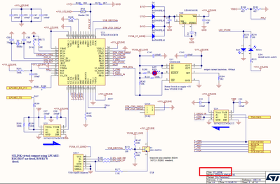

For reference, I’ve attached the schematic of the board to help clarify my question.

This is the onboard STLINK-V2 module (STM32F103) to program/debug the target MCU (STM32L476).
You need to read the title of each schematics sheet at the bottom left corner:
Hope that answers your question.

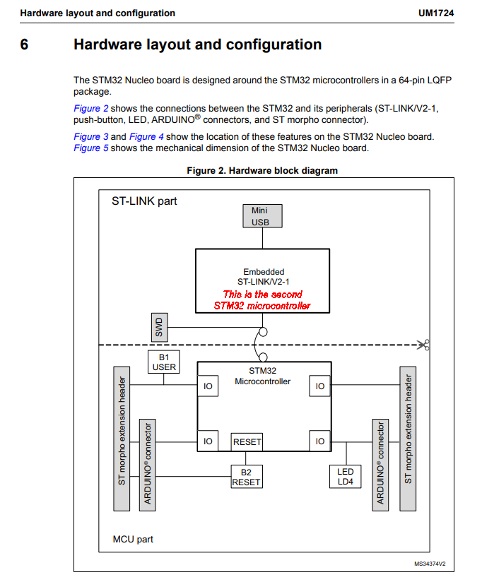

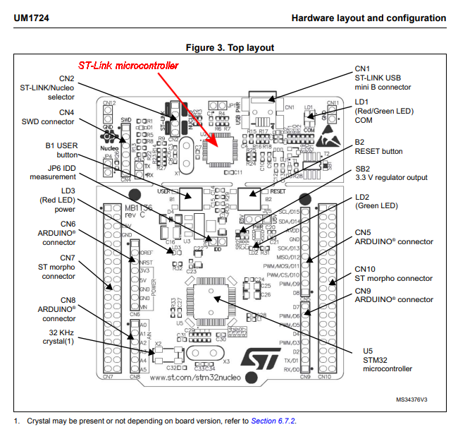

2024-12-20 3:41 AM - edited 2024-12-20 3:46 AM
@Sujith wrote:I’m curious about the purpose of this secondary microcontroller. Does it serve a specific function that cannot be achieved without it?
Yes: as @mƎALLEm said, it is the ST-Link:
@Sujith wrote:could the board still function effectively without this secondary controller?
Yes - but you would then need a separate, external ST-Link (or equivalent) to program, debug, and provide VCP.
In fact, the Nucleo-64 boards (as shown above) are specifically designed so that you can snap-off the ST-Link part!

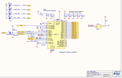

Some of the EVAL boards also have an additional MCU doing IO Expansion, basically mundane stuff like IO for LEDs as frequently all the pins of the primary MCU are soaked up demonstrating primary function, ie external memory, LCD/video interfacing, etc where pin usage/escape options are limited. The board and primary MCU are relatively expensive, and the MFX devices are cheap sub-dollar IC.
Think doing Servo encode/decode, 32-bit shaft encoder, keyboard, multiple UARTs, data logging, radio comms, etc.
You can partition the design, reduce complexity, remove mundane donkey work from primary function/goals.
2024-12-20 4:06 AM - edited 2024-12-20 4:34 AM
Yes for some boards there is another MCU used as MFX or IO expender and it's not STM32F103 but I think it's STM32L1x and for STM32L476 there is no MFX module on it.
This is the MFX on STM32F769-EVAL:
